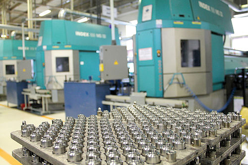

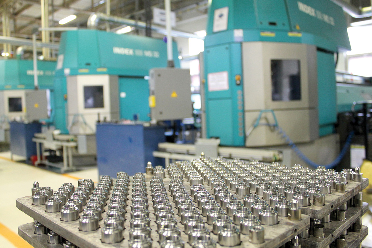

The decision by Cengiz Makina to purchase three INDEX MS32C multi-spindle machines in 2006 was based, on the one hand, on the good experiences with INDEX TRAUB, and on the other hand, on a new large order from Bosch for nozzle bodies. The performance of the INDEX MS32C was no small factor either.
>> It was a deciding factor for us that even difficult materials can be machined reliably. << (K. Mert Yilmaz, Managing Director Cengiz Makina)
The MS32C provides six individually driven motor spindles with C-axis functionality, speed control to ensure the optimal cutting rate, favorable chipping, and short machining times, as well as twelve independently operating, CNC-controlled tool carriers, which can be equipped with one or two travel axes as an option. K. Mert Yilmaz, Managing Director of Cengiz Makina, explains: “For us, the high torque was also a deciding factor, since it allows even difficult materials to be machined reliably.”
This investment was the first step in a successful collaboration between Cengiz Makina and INDEX in the field of CNC multi-spindle technology. In the meantime, of the 31 total multi-spindle turning machines, more than half of them are from INDEX – trending upward. Alongside the INDEX MS32C, there are also INDEX MS22C machines – three of which are in eight-spindle configuration. These machines are predominantly used for large-scale production.

The importance of reliable processes is make clear by the imposed requirements. Mert Yilmaz tells of a zero-defect target that must be met: “That is to say that from the first to the millionth part, every one must have the same level of quality. We achieve this, but to be completely sure, we have installed a 100% check downstream of every machine.”
Particularly when dealing with complex components made of demanding materials, Cengiz Makina only uses INDEX MS machines, which is the case when machining stainless steel for injection components for gasoline and diesel engines. The Managing Director explains: “90% of our INDEX multi-spindle turning machines currently machine heat-treated steels and stainless steel. We can‘t achieve the required reliability on the other multi-spindle machines.”
Their precision also speaks for the INDEX MS machines, as Mert Yilmaz explains: “Using the INDEX machines, we can turn to exactly 10 µm, ensuring process capability.”
