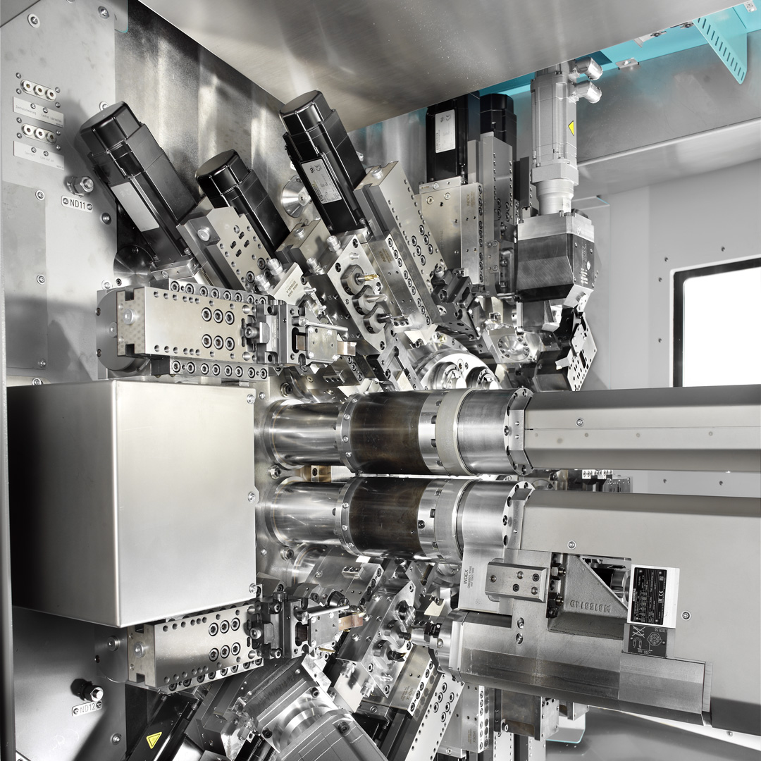

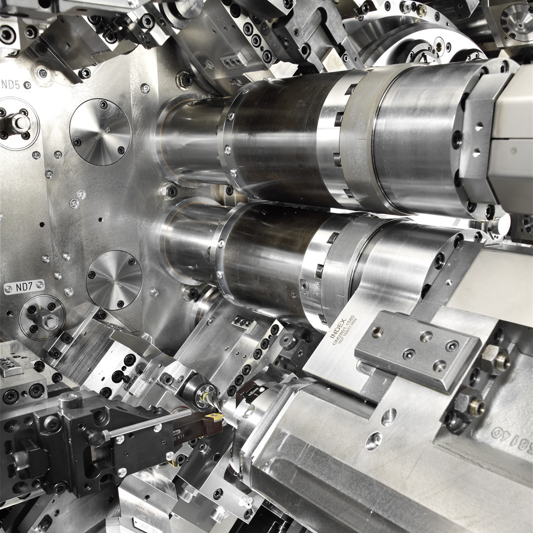

The thermostable spindle
Our trade mark –
the spindle drum
The compact spindle drum ensures maximum precision in each position through the use of a three-piece Hirth coupling. The basis is composed of 8 fluid-cooled motorized spindles integrated in the spindle drum. Infinitely variable speed control, (high dynamics) compact design,maintenance-free and the latest synchronous drive technology, as a guarantee for high-precision workpieces.
![](/fileadmin/_processed_/9/6/csm_INDEX_MS40_0006_b22416b1a1.jpg)
Independent speeds
During machining, the optimal speed, which can still be varied during cutting, can always be programmed for each spindle position and each cutting edge of the tool. The result is better chipping, maximum surface quality, short part production times, and longer tool service life. You can also machine high-strength materials that up to now were hardly suitable for multi-spindle machines. It is also possible to make speed changes during drum indexing, thus avoiding any additional secondary processing times.

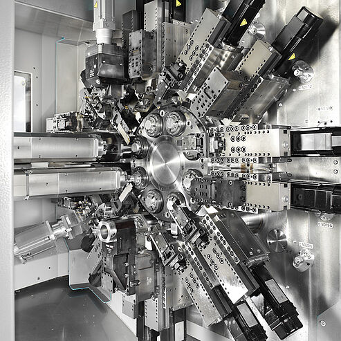

Machine configuration
Full extension
- 14 tool carriers with 1, 2 or 3 axes
- Back-drilling slide with 7 tools thereof max. 4 driven for face machining
- Multiple occupancy of the slides possible
- Only the tool holder determines the machining direction (inside or outside)
- Cross machining with driven tools
Your benefit: Cycle time reduction due to 8 working spindles

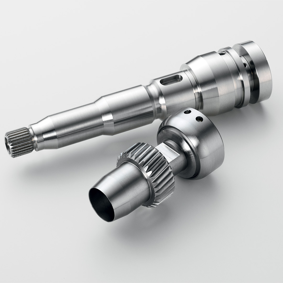

More than just turning
INDEX CNC multi-spindle machines with live tools, C-axis, and Y-axis give you access to entirely new processes, such as: Off-center drilling and thread cutting, inclined drilling, cross drilling, contour milling, hobbing (tooth cutting), polygon turning.
