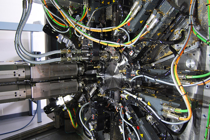

The modular eight-spindle MS22-8 offers Hammond additional opportunities for extremely fast multi-spindle parts machining, especially highly complex parts with applications from automotive to medical technology. It also produces small batches efficiently and economically, and can be bar-fed or loaded with chucked parts.

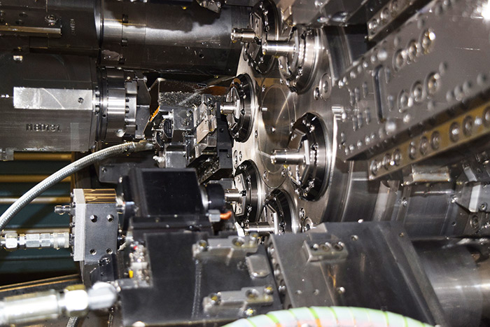

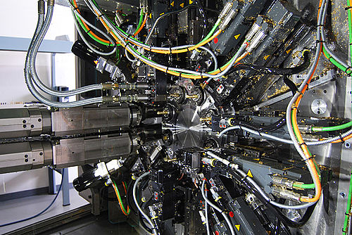

The INDEX MS22-8 can be configured to operate as an eight-spindle machine, a double four-spindle machine that drops two complete parts at a time, or as a machine with double rear-end machining. Highly versatile, it is capable of turning, off-center drilling and thread cutting, inclined and cross-drilling, milling, multi-edge turning, hobbing, tooth milling, deep-hole drilling or slotting.
At Hammond, the MS22C-8 in double four-spindle mode actually runs as two machines working with each other simultaneously on a single base. Every second tool station always has simultaneous access to the same tools.
Each of the eight spindles, arranged in the well-known INDEX spindle drum, are assigned two cross slides which can travel both on the X and Z axes. Each cross slide can be also equipped with a Y-axis. Up to two swiveling synchronous spindles permit simultaneous rear-end machining. With a total of up to 16 cross slides, the eight-spindle machine gives Hammond an edge for the highly complex machining its customers’ parts require.

When operated as an eight-spindle machine, the MS22-8’s drum indexing angle from spindle to spindle is 45°. If the machine operates with two times four spindles, the drum indexing angle is 90°. With double four-spindle machining, two finished parts are produced by the machine per work cycle.
Hammond continued, “The difference between the cam-type machines and this multi-spindle CNC is that, although we may not be able to make a part quite as fast as a dedicated cam machine, we can make two parts within the same cycle. So one machine tool is making two parts in every cycle instead of one, and it doesn’t have to be the same part.”
The speed of each of the eight spindles can be controlled separately. The liquid-cooled spindle drum keeps the thermal growth in the spindle carrier to a minimum, and the spindle bearing temperature can be kept at a low level, which also supports service life.
The cross slides with integrated drives have a low-mass design with hydrostatic bearing support. Their low moment of inertia and resulting high dynamics facilitate outstanding acceleration in operation, further reducing cycle time.
Reference a particular part, Hammond said, “On this part, previously, the cycle time was 82 seconds. It is now about 20 seconds, with the MS22-8 dropping two at a time. The machine is actually splitting the time, doing a lot of work on the back of the part, using all eight spindles to produce the complex part.
“The unloaders at station 7 and 8 know which part to unload as the spindle drum changes position to cycle around to present the part to the next station. This unloading capability alone saved us about 20% on cycle time. The two-part processing capability permits backworking, yet does not slow down the drum from rotating. I love what that technology does,” Hammond said.
After front machining, for which six spindle positions are available, workpieces are picked up by two rear machining units and machined simultaneously on the rear end.
Because rear-end machining is done during two drum indexing cycles, up to six tools can be used for this simultaneously with the other spindles. With all cross slides located at the same travel angle to one another, free chip flow is guaranteed in each position.
