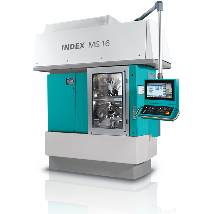

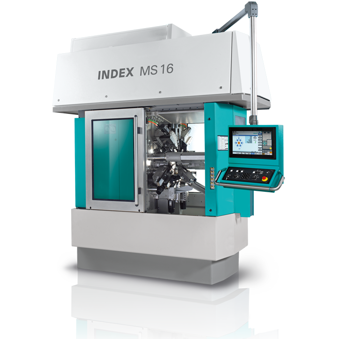

INDEX MS16-6 / MS16-6 Plus
Multi-spindle automatics
  • 16 / 22 mm bar diameter
  • 10,000 rpm max. speed
  • 15 kW max. power
  • 18 Nm max. torque

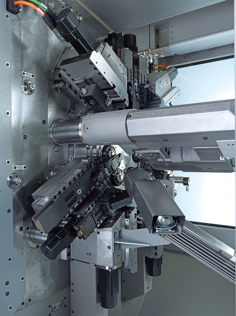

Dynamic multi-spindle machine
Shortest possible changeovers, ultra-high dynamics and lowest secondary times are the basis of minimal cost per part.

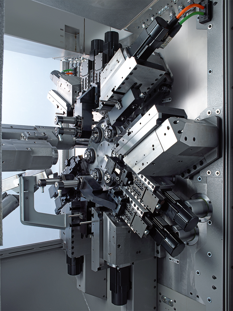

  • Grooving slide for maximum cutting performance with minimum machining time
  • Quick tool setup by INDEX W-serration

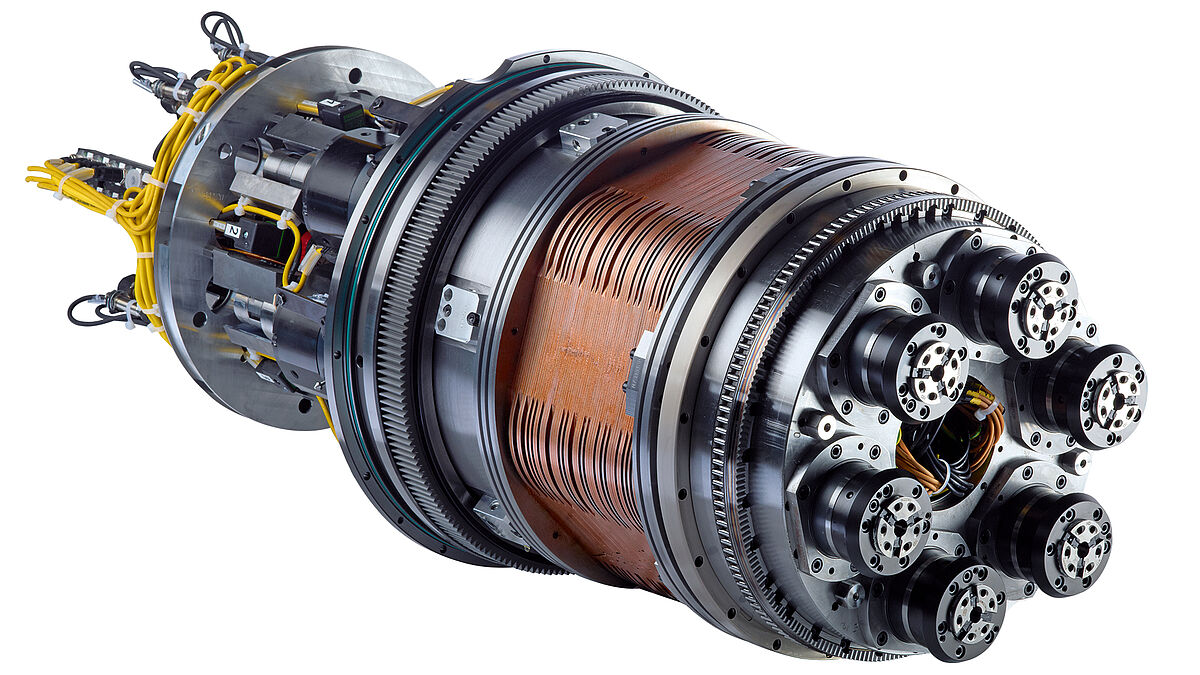

  • Spindle drum with individual drives of the work spindles
  • Cross-slide for flexible complete machining
  • CNC cutoff slide with extended stroke for rear end machining
  • Highly dynamic synchronous spindle with extremely short acceleration and deceleration times
  • Up to 22 mm bar diameter with version MS16 -6Plus

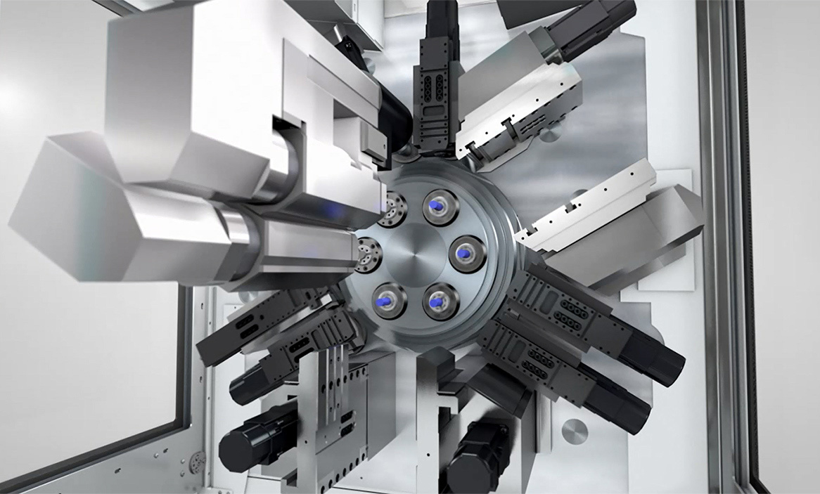

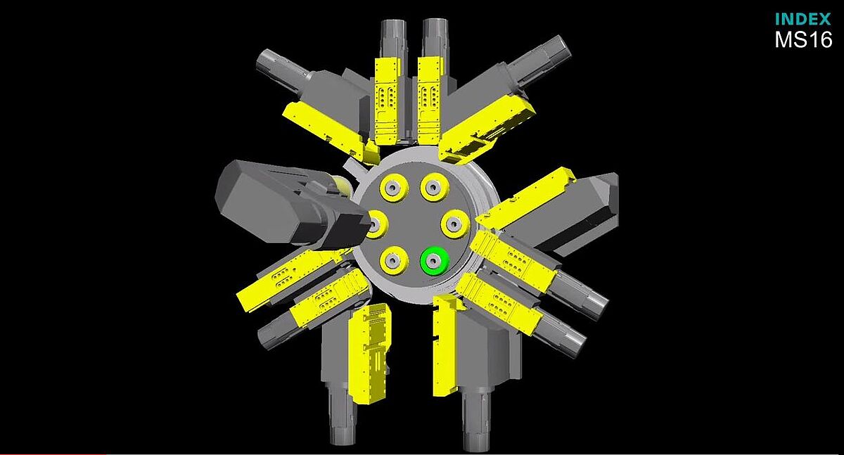

  • A maximum of 12 tool carriers with 1 or 2 travel axes
  • Fast synchronous spindle for rear end machining
  • Several tools per cross-slide possible
  • Variable use of tool carriers, internal-external, stationary or live
  • C-axis machining possible in every spindle position
  • Polygon turning and other machining options

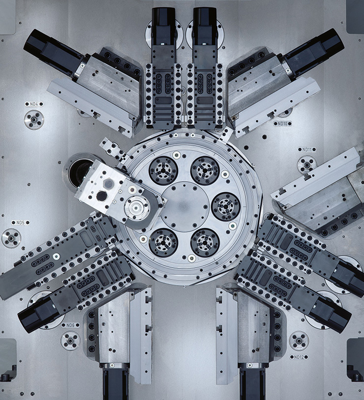

Extended version MS16-6 Plus
• Synchronized spindle in position 5.1/6.1
• Cutoff and back-boring slide in position 5.2/6.2
• Grooving or drilling slide 1x selectable per spindle position (1 to 4)
• Extension version with separate cutoff slide 5.0/6.0 and pure back-boring slide 5.2/6.2
• Cross slide 1x per spindle position (1 to 4 selectable)
• Double 3-spindle machining is possible on the INDEX MS16-6 plus

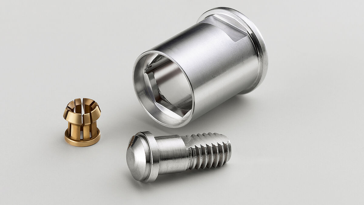

Diverse machining technologies

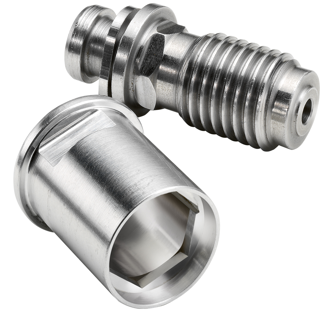

Polygonal turning
Polygonal turning is possible in longitudinal and grooving processes, even in high-alloy materials
Example: Hexagonal turning i=2:1, referring to the speed ratio of the cutter head to the workpiece
Milling
Milling with live tool, also in conjunction with C-axis mode (Transmit).
Elliptical deburring
Uniform deburring (even chip removal) of cross-drill holes based on interpolation of the C-axis, X-axis, and Z-axis with live tool.
