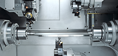

View into the work area
The INDEX C200 opens up new opportunities for high-speed production of parts turned from bar stock.
Despite its compact external dimensions, the INDEX C200 has a large-sized working area for complete machining of workpieces.
