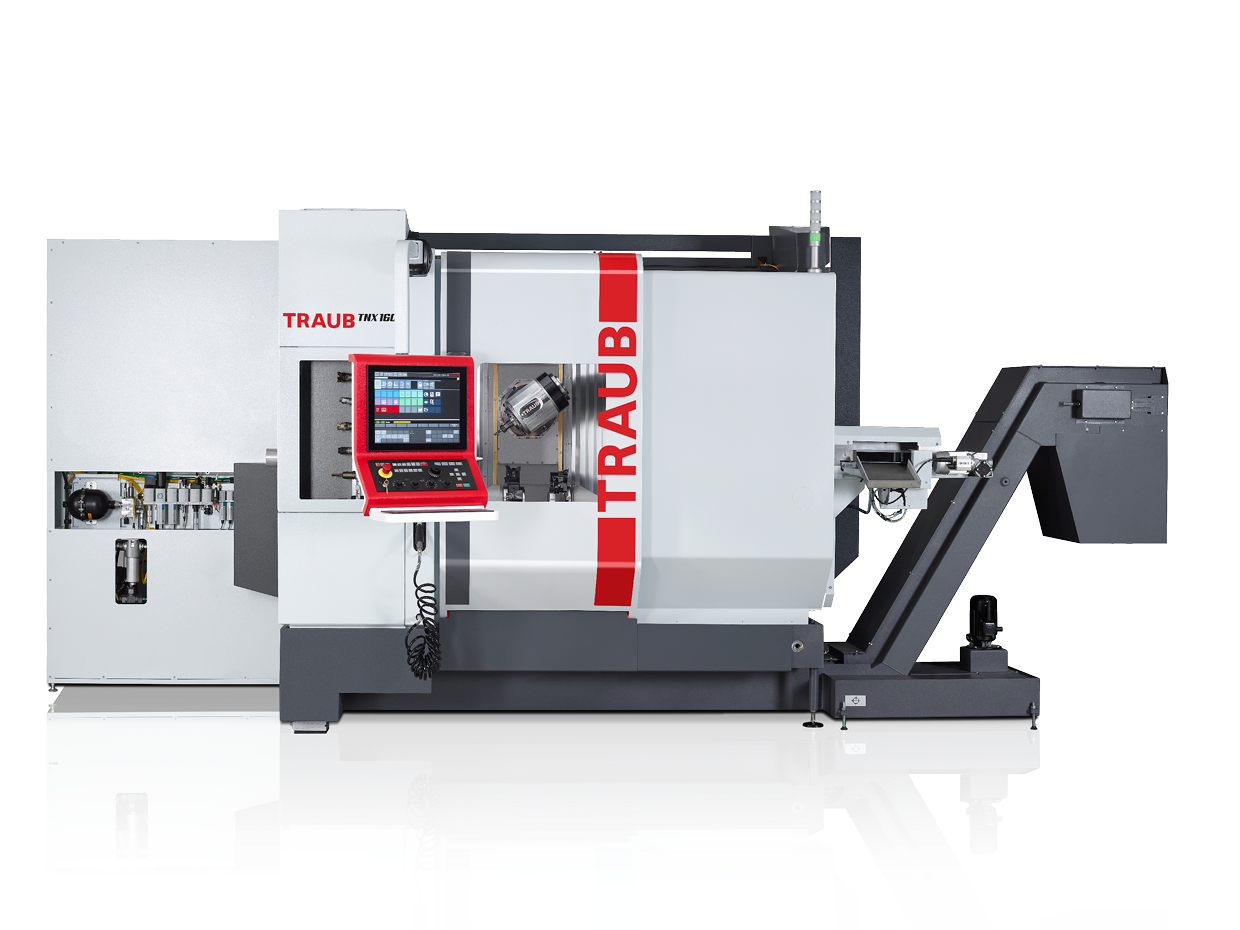

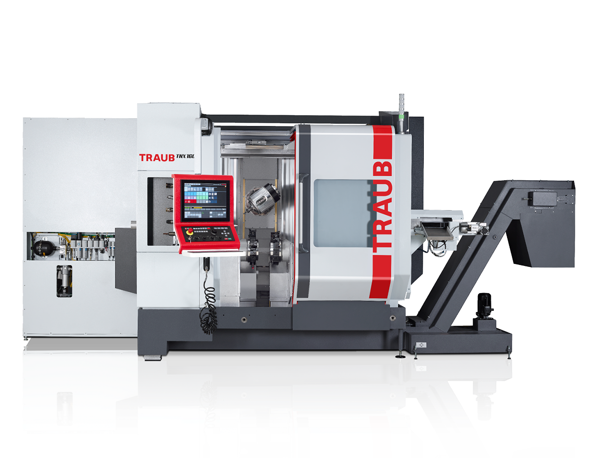

The TRAUB TNX160 is an innovative turn-mill center in a class of iits own. Especially when it comes to efficient production of small workpieces with high complexity and variability. Based on a rigid and vibration-damping machine bed made of gray cast iron and large-dimension linear guides in the X, Y, and Z axes, this series stands for state-of-the-art machine engineering and delivers excellent machining results with high productivity.
The TRAUB TNX160 is equipped with two identical work spindles. Three tool carriers, combined with a large tool capacity, ensure maximum process reliability with minimal setup effort. With up to 16 productive axes, this modern turn-mill center offers exceptional flexibility for the complete machining of complex workpieces.
The generously sized work area is unique in this class and impresses with its sophisticated features that allow simultaneous machining using all three tool carriers while minimizing the risk of collisions. The smooth, steeply sloped stainless-steel interior paneling ensures optimal chip flow.

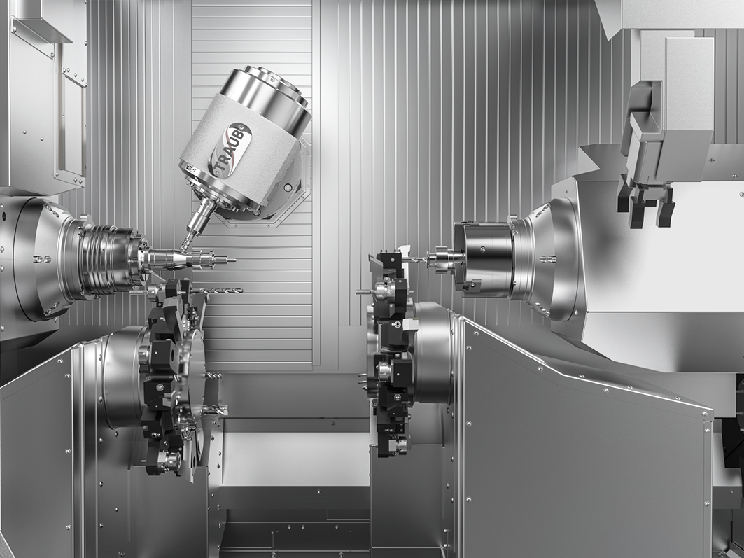

  • Three tool carriers with up to 120 tools in the tool magazine and turrets
  • Highly efficient simultaneous machining with up to three tools operating at the same time
  • Powerful motor milling spindle with Y/B kinematics and speeds of up to 32,000 rpm for complex 5-axis milling

Each of the lower tool turrets accommodates 15 VDI 25 tool holders with the proven W serration. All tool stations are designed for the use of live tools.
Two powerful motor milling spindle variants are available as options: either 18,000 rpm/29 Nm or 32,000 rpm/17 Nm.

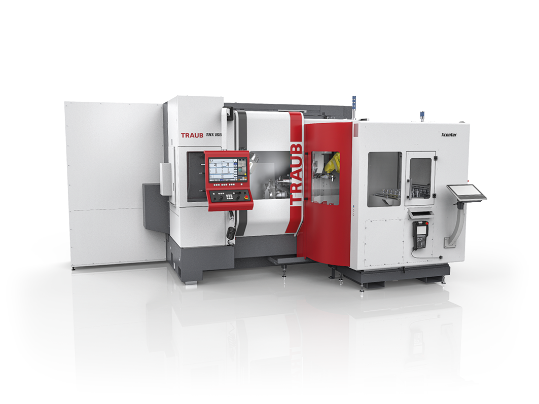

The modular robot cell iXcenter is available for all machines in this series, for flexible loading and unloading of blanks and finished parts.
Large degrees of freedom in the work area for a wide variety of machining options
Maximum productivity by simultaneous machining with 3 tools
Use of tools up to 250 mm long in the motor milling spindle, e.g. for deep-hole drilling applications with the highest precision
Turret steady rests provide for flexible shaft machining
Maximum freedom from collisions due to “submergence” of the lower tool carriers
iXcenter - INDEX automation with added flexibility and cost-effectiveness
With the optional robot cell iXcenter, blanks and/or finished parts can be loaded and unloaded quickly, safely, and flexibly.The robot cell is docked ergonomically to the machine. It can be moved easily to the right during the setup process, allowing unobstructed access to the work area.
In production mode, the iXcenter is fixed in position in front of the machine. The robot accesses the work area via the machine’s automatic door. As an option, part handling between the robot and the machine-integrated automation can be carried out via a separate access hatch using a handshake interface.
Downstream processes such as cleaning, measuring, labeling, and more can be integrated into the robot cell.

  • 6-axis robot for up to 7 kg payload with integrated gripper control
  • Double gripper as standard
  • Pallet storage for blanks and finished parts
  • Easy in-house relocation possible
