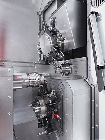

  • Two identical work spindles, two tool turrets (each with X, Z, Y axes)
  • Spindle clearance up to Ø 40 mm
  • Robust fixed headstock design

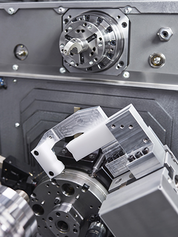

  • Stable compact-shank tool holders for precise milling
  • Optional single drives available for tool stations

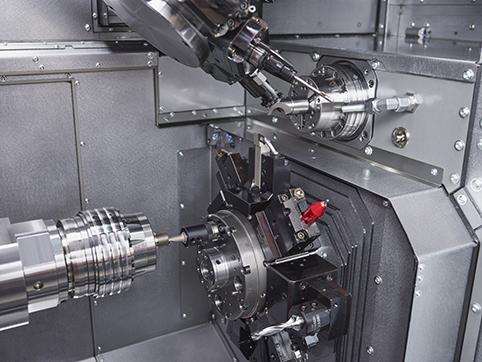

  • Up to three tool carriers and one back working unit, all with Y axis
  • Simultaneous machining with two, three or four tools
  • Large tool pool for setup-friendly production
  • Short tool change times
  • Generously dimensioned work area designed for process reliability
  • Flexible hydraulic hollow clamping system (main & counter spindle)

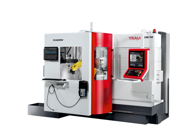

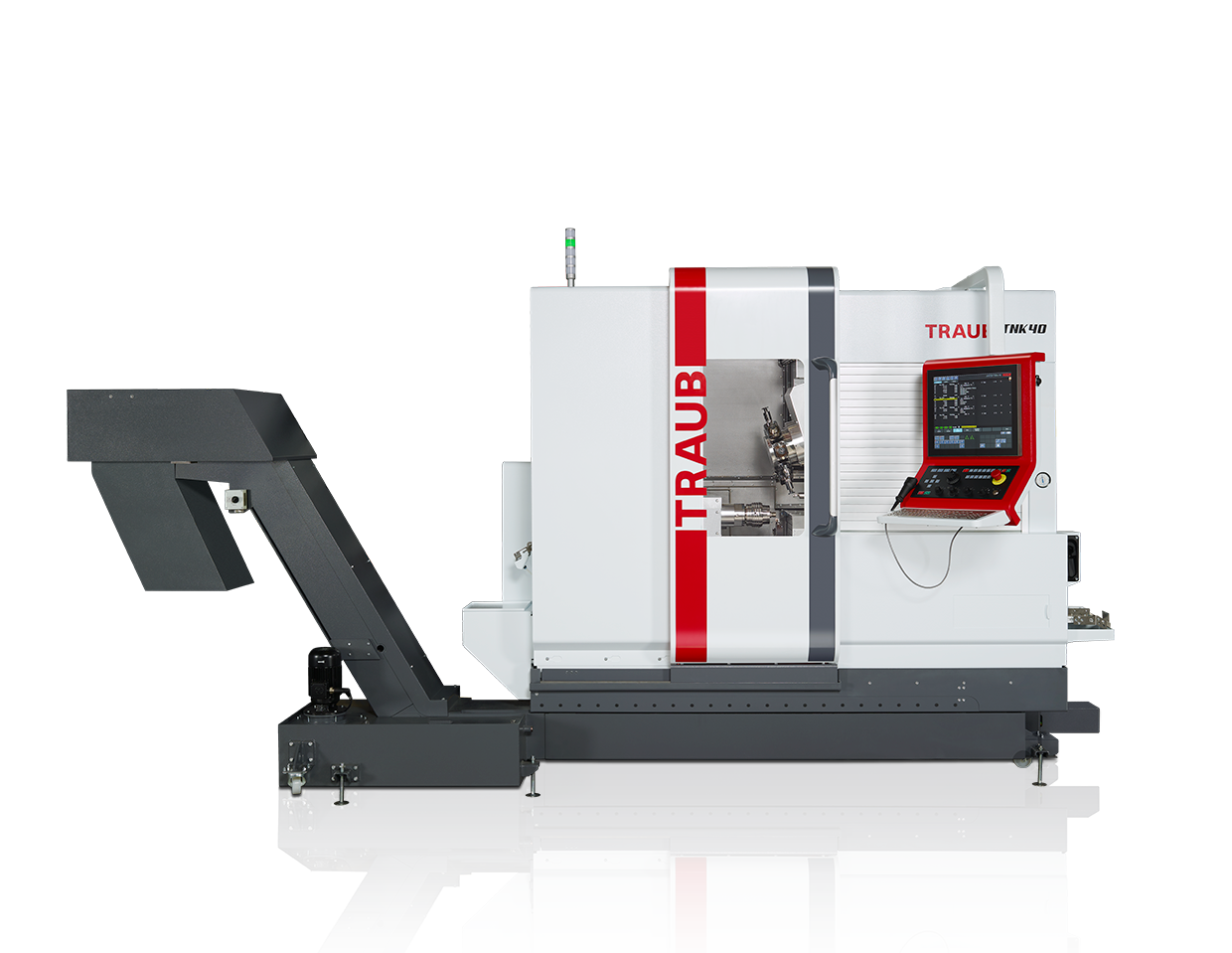

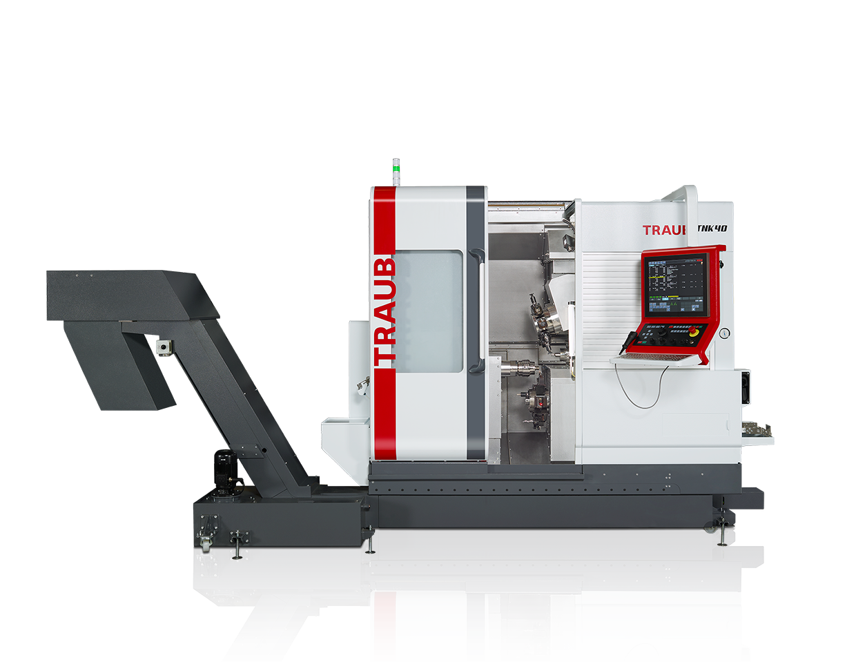

Machine concept TRAUB TNK40

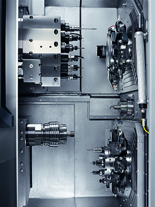

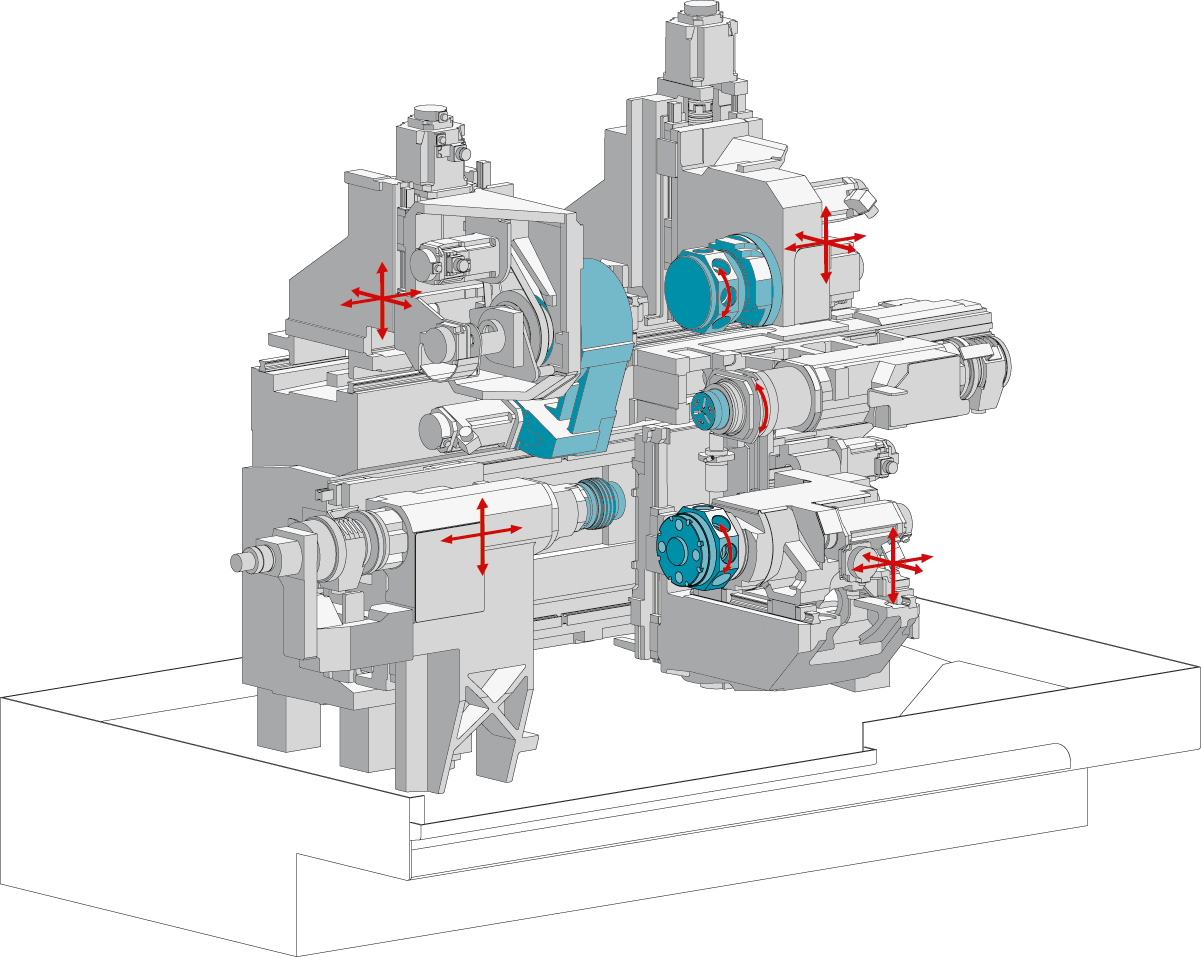

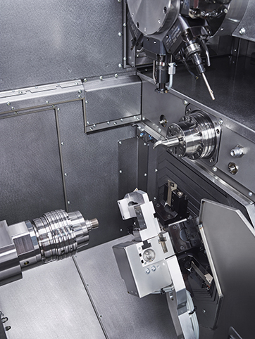

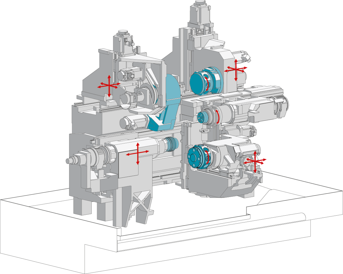

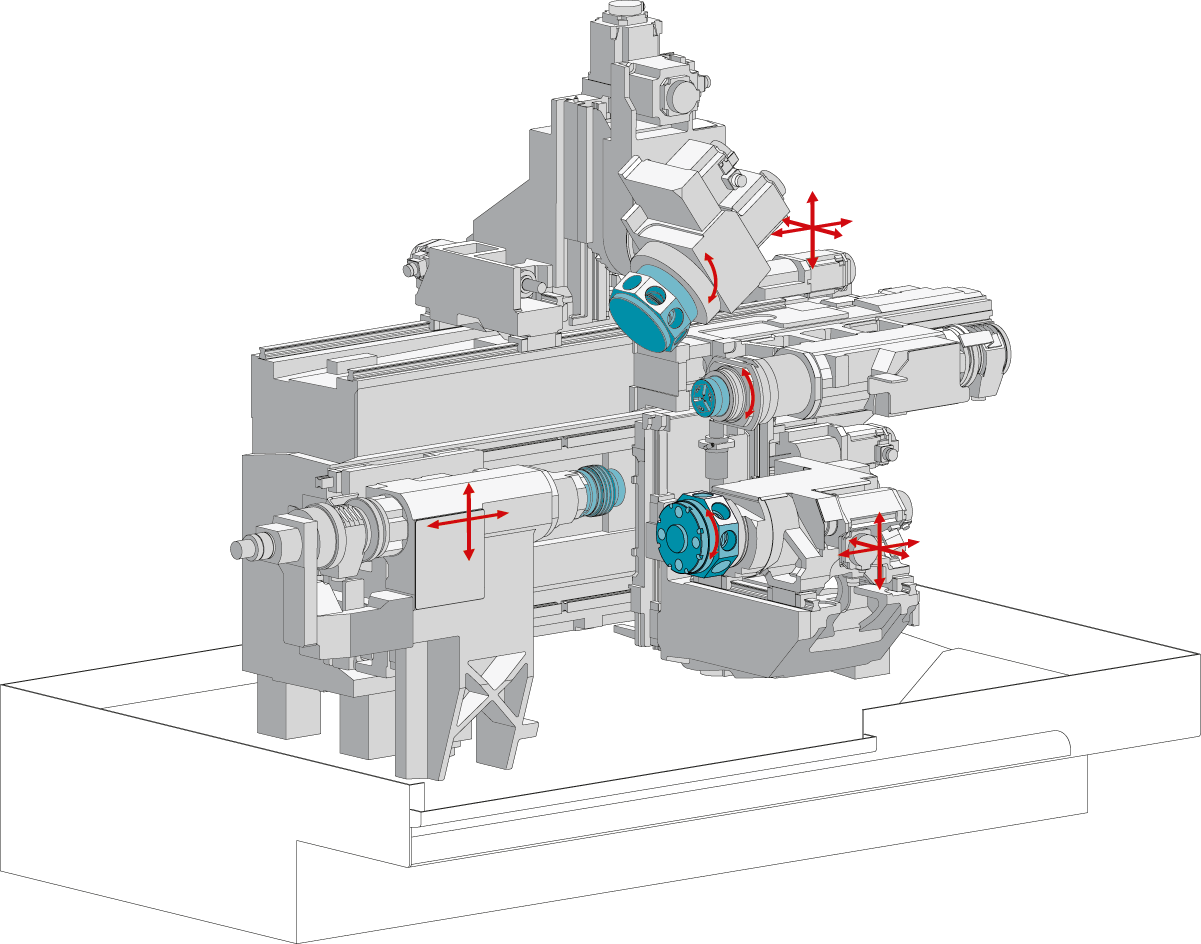

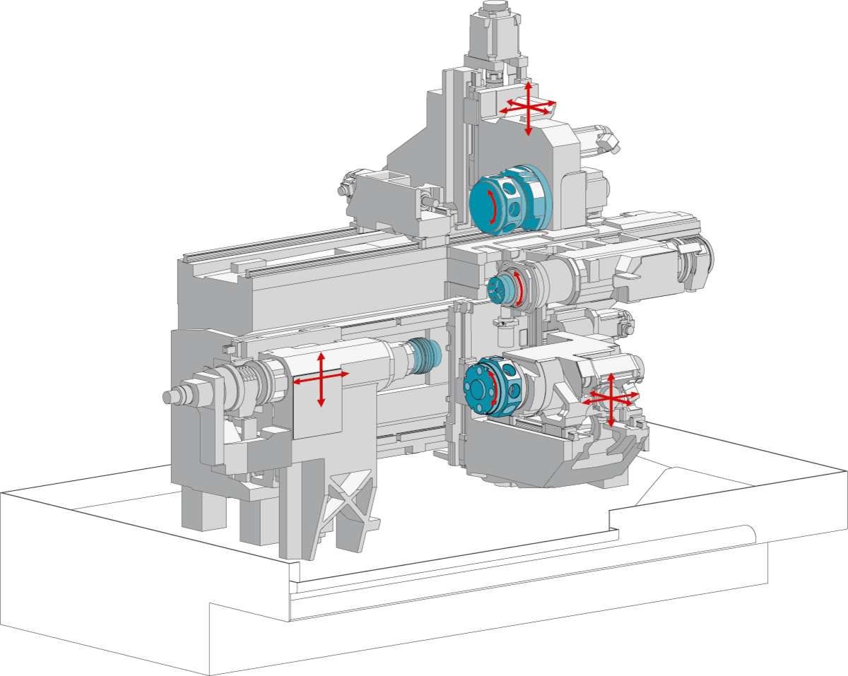

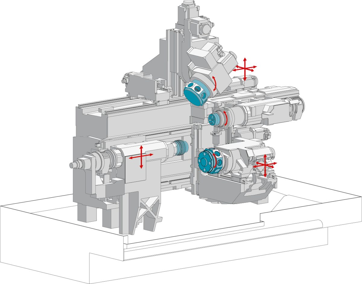

The TRAUB TNK40 has two identical work spindles and two tool turrets, each with X, Z, and Y axes. It can also be equipped with a front and back working unit. The upper tool turret can be equipped with an optional B axis.
This production turning machine combines the productivity of a very high-performance turning machine with the precision and efficiency needed to machine complex workpieces with ease.

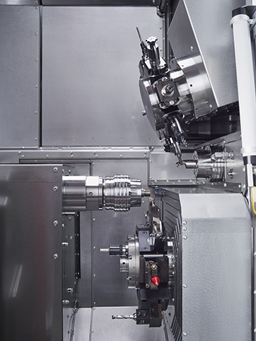

With its compact footprint, the work area of this production turning machine—which is unique in its class—ensures a very high power density for cost-effective production. In addition, the vertical work area concept provides optimum process reliability combined with minimal setup effort.
The work area concept allows simultaneous and productive machining with two tool turrets and a front and back working unit.
TRAUB TNK40 in focus
The 3 configuration variants of the TRAUB TNK40
TRAUB TNK40-8
TRAUB TNK40-8B
TRAUB TNK40-10
